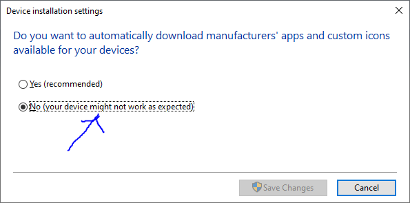

You can turn off Windows Updates ability to update drivers. I recommend it. One should get drivers, only from the manufacturer of said hardware.
Those driver update programs can cause more trouble than they help.
Hit start, type device installation, change device Installation Settings should show and you click this. Choose No.  The sentence in parentheses is not true.
Hopefully this will prevent these issues in the future. You will  have to check the setting periodically as it will reset after every major feature update.
I learned this from another very educated and experienced user on other forums named jenae, I'm sure Corrine can vouch for him.
