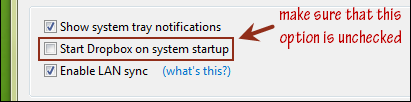

If memory serves, Dropbox rewrites its autostart config file at every start-up.
What does the Windows task manager report (Ctrl+Shift+Esc)?  Running or not?
Start Dropbox manually.  Is the "Start Dropbox on system startup" box checked when you right click on the system tray icon?
geezer
Thanks winchester73
I had the program set to start with Windows. I realize now, that WP needs just a little common sense help, to accomplish what the user desires.
