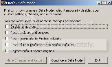

*** ME AGAIN:
if this simply has the effect of "DISABLING ALL ADDONS" --
A) why can't i just click "DISABLE ADDONS" within my current FF window
and
B) aren't either of these options dangerous, in that they'll allow everything my addons were blocking? (javascipt, FLASH, etc).

An easier step might be to load "Fx Safe Mode" as I am using, now, while I post this.  Plugins aren't effected, just add-ons, themes, etc.
Dangerous?  Remember, the best add-on to ANY browser is between your ears.
I feel a bit more "blind" w/ no add-ons as more ads display and I can't see what scripts are running on each page per NoScript, but I am only surfing to sites that are known to me while doing this troubleshooting task.
Close all Fx sessions, go to All Programs>Mozilla Firiefox>Firefox (Safe Mode)
Here's what you will see:
Tip:
Do not check any of the boxes/options, just click "continue safe mode."
When you are done, close Fx and start the way you normally would, or w/ All Programs>Firefox.
