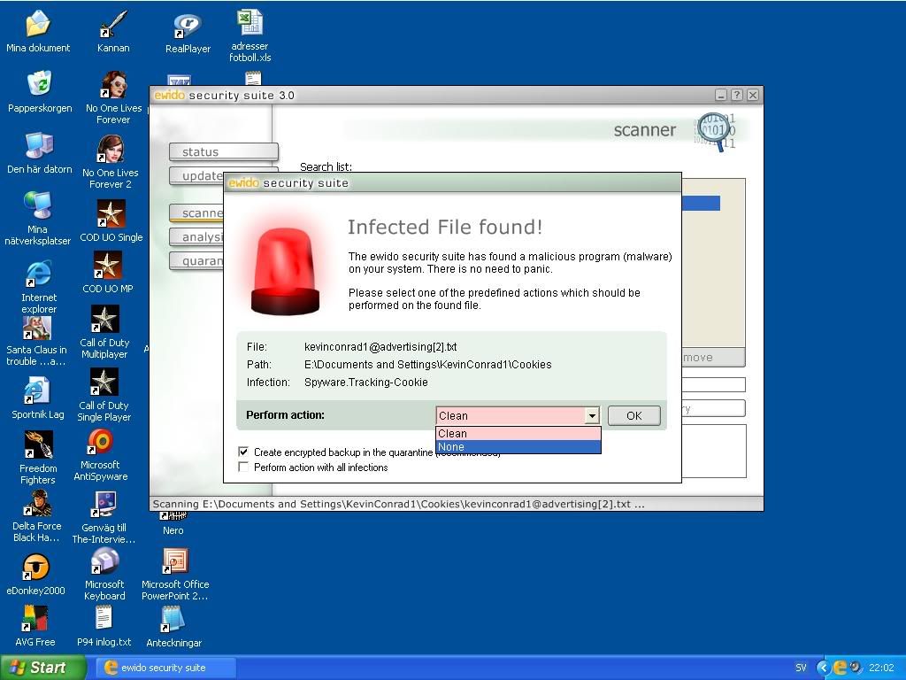

Please go here and download   Ewido Security Suit:
http://download.ewido.net/ewido-signatures-full-20051116.exe
It´s a complete installer, supplied with the latest definitions designed to be used in situations like this.
You need to burn it to a CD, when it´s 4,3Mb in length.
At the same time, download and add to the CD also the "WinsockFix" : http://www.tacktech.com/pub/winsockfix/WinsockFix.zip
A quick guide to Ewido Security Suit is found here:
http://www.greyknight17.com/spy/Tutorials/ewidoQuickGuide.pdf
1. Install ewido security suite
2. Reboot your computer to Safe Mode. You do this by rebooting and during the startup process tap the F8-key repetedly until a screen appears where you navigate with the arrow keys. Choose "Safe Mode" and hit "Enter".
Once in safe mode, go on with this:
3. Launch ewido, there should be an icon on your desktop double-click it.
4. The program will now go to the main screen
5. Click on scanner
6. Click on Complete System Scan and the scan will begin.
7. On the first alert, a window will open prompting you to take action. Checkmark "Remove" and "Perform action on all detections".
Screenshot:  http://i18.photobucket.com/albums/b123/DieHard53/EWIDO2.jpg
8. Once the scan has completed, there will be a button located on the bottom of the screen named Save report
9. Click Save report.
10.Save the report .txt file to your desktop.
11.Now close Ewido security suite and reboot normally.
12.Run the "WinsockFix" and follow the prompts on the screen.
13.Try your internet connection.
14.Copy the Ewido report (to the CD) and post it here for review.
regards
Die Hard :)
