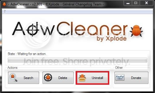

Please do the following to uninstall AdwCleaner.
  • Double-click AdwCleaner.exe to run the tool.
  • Click the Uninstall button as shown below.
  • Confirm with yes
AdwCleaner will now be uninstalled.
