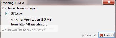

3.  Please download Junkware Removal Tool to your desktop.
Note:  A few seconds after landing on the above link, depending on the browser you are using, you will see the following:
  • If you're using Firefox, click Save file:
  • If you're using IE, click Save:
  • Disable your protection software now to avoid potential conflicts.
  • Run the tool by double-clicking it.  If you are using Windows Vista or Seven, right-mouse click it and select "Run as Administrator".
  • The tool will open and start scanning your system.
  • Please be patient as this can take a while to complete depending on your system's specifications.
  • On completion, a log (JRT.txt) is saved to your desktop and will automatically open.
  • Post the contents of JRT.txt into your next message.

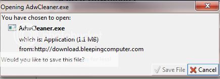

4.  Please download AdwCleaner by Xplode onto your Desktop.
  • If you're using Firefox, click Save File:
  • Close all open programs and internet browsers.
  • Double click on AdwCleaner.exe to run the tool.
    Note:  Windows Vista, Windows 7/8 users right-click and select Run As Administrator.
  • Click the Scan button and wait for the process to complete.
  • Click the Report button and the report will open in Notepad.
IMPORTANT
  • If you click the Clean button all items listed in the report will be removed.
If you find some false positive items or programs that you wish to keep, Close the AdwCleaner windows.
  • Check off the element(s) you wish to keep.
  • Click on the Clean button follow the prompts.
  • A log file will automatically open after the scan has finished.

Sweet!  I don't know how much AdwCleaner will find after that but go ahead and give it a run also.
