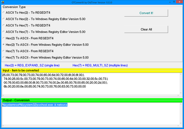

icotonev
Quotehe ImagePath of wuauserv: "%systemroot%\system32\svchost.exe -k netsvcs -p".
The Windows Update service is totally incorrect..!
ImagePath has to be : %systemroot%\system32\svchost.exe -k netsvcs
Download the attached files (wuauserv.reg) and save them to your desktop.
wuauserv.reg
  • Double-click wuauserv.reg
  • Allow the information to be merged into the registry if prompted. (click Yes)
  • Restart the computer.
Hristo Tonev (Ico)
