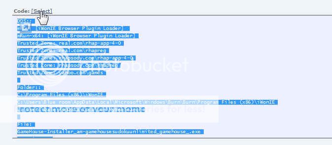

i cannot get it save the code stuff in notepad
Hi, Marie.
You can do it!
  • Open Notepad.
  • With Internet Explorer, click Select from the code box in the above instructions, as illustrated in the image below.
  • With your mouse in the box, right-click with your mouse and select copy as shown:
  • Then return to Notepad and right-click your mouse in the open space and select paste
  • In Notepad, select File, Save as.
  • In the file name, it should read CFScript.txt
  • Save the file to C:\Users\Blue room\Desktop
  • As indicated in the screenshot above, drag CFScript.txt onto ComboFix.exe.
